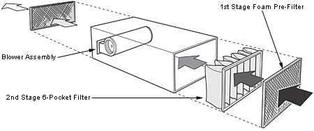

So, I've been wanting to build several things for the shop, a Cyclone dust collector is on the list as well as a ceiling mount air cleaner. I have seen one process on the net here but I would like some other ideas, mostly about the fan/blower. What or where would I find a blower for a standard air cleaner? Does anyone here know?
How about a couple of range hood fans, would that be enough CFM I wonder? I can buy the the filters at Lee Valley for around $40 for the 6 pocket filter and the other can be a simple furnace filter I think.
This is the layout I'm thinking of, but I just need the blower.
As most of you know by know, I'm cheap and I like to build things myself so this and the cyclone should be no surprise.

    I made one and gave up on it. I then bought one from Grizzly. An investment. It really helps. You do want to be able to move the volume of your shop about 6 to 8 times and hour.
     Your health is worth every cent. Blower fans and such do not have the power. Save your time and money and buy one allready made. You need alot of cu ft / min

John, I've been thinking about that and my shop is only 185 sft, so if I even what to clear the air 10 times per hour, I would only need 250 CFM (minimum) I was thinking of using two range hood fans, they are about 250 CFM each, I'll try it I think and if it doesn't work, than I'll probably buy one.

You have to understand that that rate is figured in open flow. When you put a 20 micron filter with a 5 mircon flow bag you will kill that flow and those fans don't have that kind of power. You need a good 1/2 to 3/4 hp squirell fan.
   They have the power but till you go and spend that hind of money along with the time you can buy something that is engineered and box ready. I have a large shop 24 by 40 2 floors and the unit for my shop was $200. Worth every cent and then some.
    I know it can be fun making your own stuff but the one I made cost about $40 more than the one I bought and works 10 times better , and I ain't no slouch.
   I think what makes the bought unit so much better is
1 remote control and on a timer
2 the fan though a squirel fan has a different blade
3 the filters are comercially available and designed for air cleaners , not furnaces
4 the inside 5 micron filter bags make this a 2 stage filter and the flow is speed is adjustable in 3 speeds for when I am working and putting dust in the air
and other speeds for just filtering air and a third speed I can run after I leave to clean the air and keep alot of dust from settling.
    Sometimes cheaper costs more
